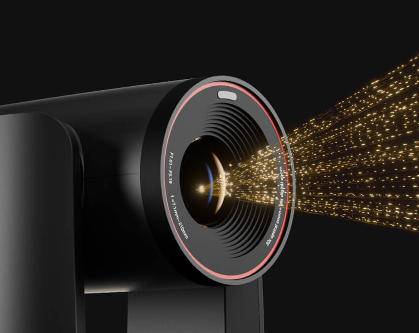

Live venues aren't always well lit — halls, auditoriums, and churches often present challenging and complex lighting environments. The Astra P1's 1/1.8” sensor increases per-pixel light intake to deliver crisp, noise-free 4K footage.

Up to
30x
optical
Effective Pixels
8.42
megapixels
Image Sensor
1/1.8″
CMOS
1x
10x
20x
30x
